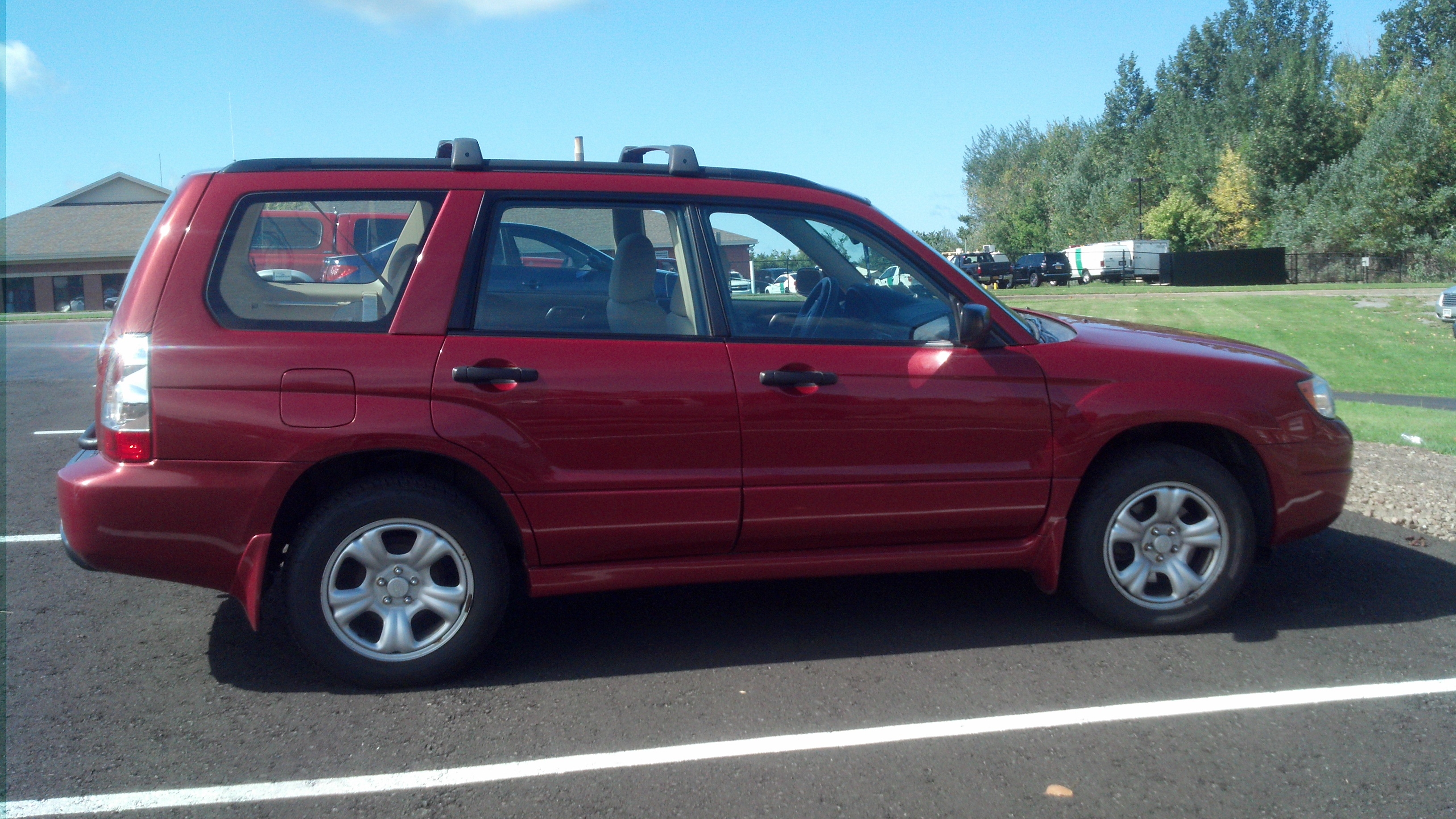

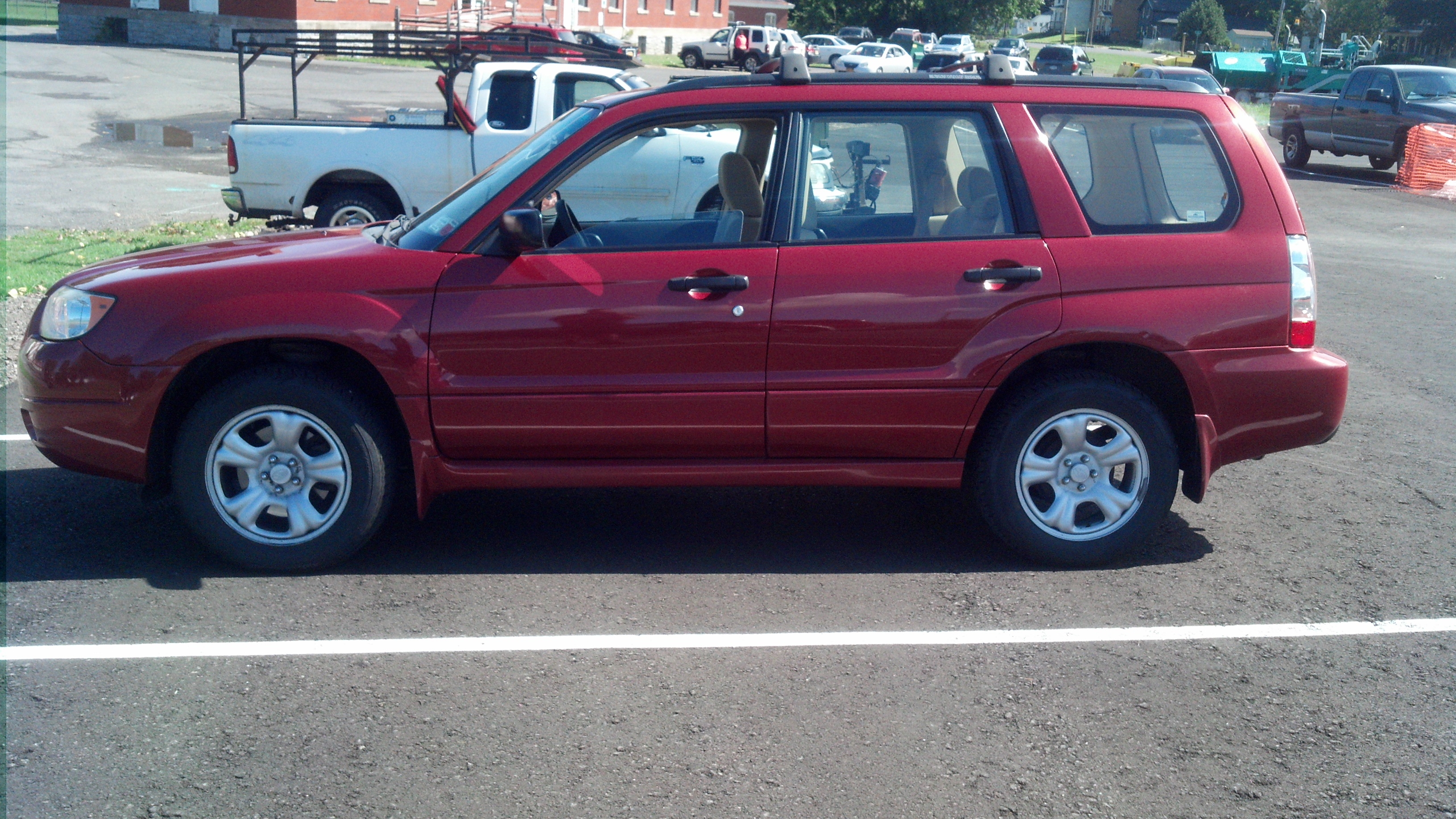

I somewhat recently, reluctantly purchased a 2007 Subaru Forester AT (non-Turbo) with 69,000 miles off my aunt-in-law. I say reluctantly because she would not allow me to get it inspected before I purchased it citing that her "mechanic" that had done all the work to it since the day she purchased it brand new from the lot said it was in "perfect condition". I used to work at a dealership when I was younger so I know you ALWAYS get a car checked out before you buy it. However, since it was family, she was elderly and needed the money & I had the extra money I bought it knowing that it could potentially have every problem imaginable. After purchase I took it to a Subaru dealership in Syracuse NY and had them do a full inspection on it. They came back telling me that it had cracked head gaskets stating it was in the "very initial stages" and that the 60K service was never done (which her mechanic lists in her owners manual as completed but from the air filter, color of fluids it looks like he never did the 60K or the 30K service).
The car runs fine aside from the rough idle for the first 2-5 seconds after starting it. I do not have white smoke as of yet. I only get a slight burning oil smell briefly if I floor it (which I have not done since getting the news from the dealership). It makes me a little sad that she kept the outside of the car up so well but didn't take it to a proper shop to have the service done. I do like the car (I wish it was the XT & Manual) and want to fix it but when it comes to head gaskets on a Subaru.....that is just not a repair I feel comfortable having a small local shop in this area do unless they are experienced with Subarus. I have since purchased all the parts needed for the repair: New blue racing belts from Gates, a 6 Star Head Gasket kit that includes the valve cover gasket, head bolt kit/set, spark plugs, new oil filter, oil, new coolant. coolant system conditioner, etc.
Could someone please recommend a local shop or person that could do the repair/install the parts?
Since those pics were taken I have added:
