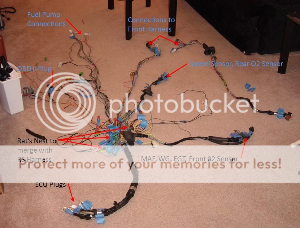

Dan and I got the harness trimmed down over the weekend. It's amazing how much wiring our cars have! Its also a total cluster in there because everything is ran together. You've got audio wires running next to your fuel pump lines right along with your interior and exterior lights! What a mess. I have some before, during and after pics, but I can't find the cord for my camera! Its buried here some where...I really should clean my desk off.

The harness as received from Dan:

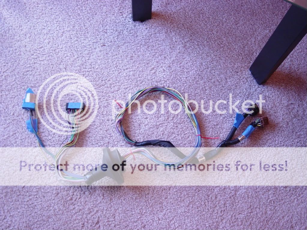

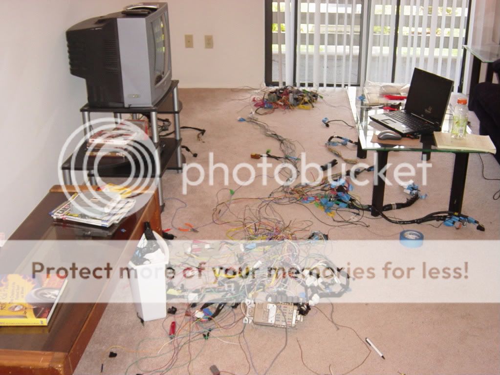

Believe it or not, there's two separate pieces in there - the bulkhead harness, and the front body harness. Here are the two pieces laid out in my living room with everything that I'm keeping tagged. For reference, my living room is at least 15ft x 12ft.
Progress after Dan left, about 6:30 Saturday - only 6 wires left!
This is all that is used from the front harness - just the engine plugs that come in from the left fender.

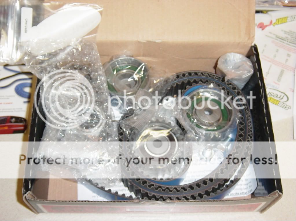

Gates Racing timing belt, PCI timing belt tensioner and idler bearing kit

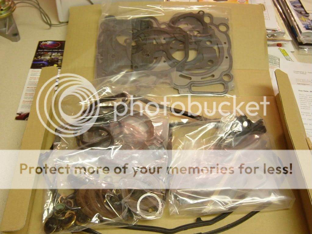

Subaru Engine Gasket/Seal Kit

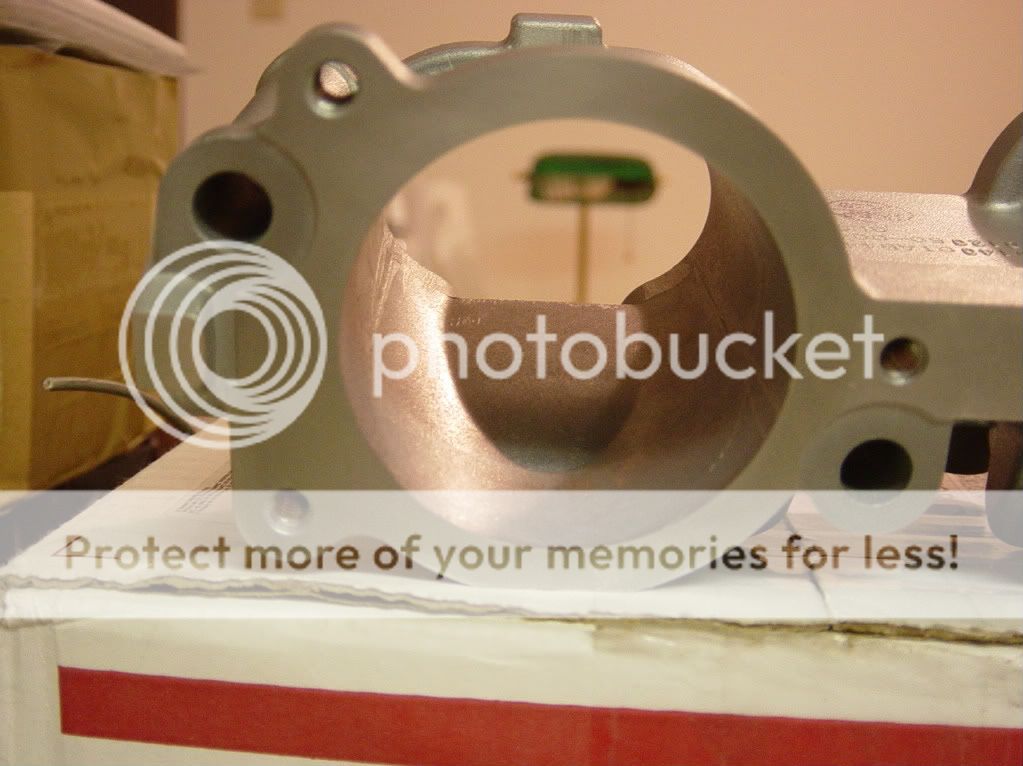

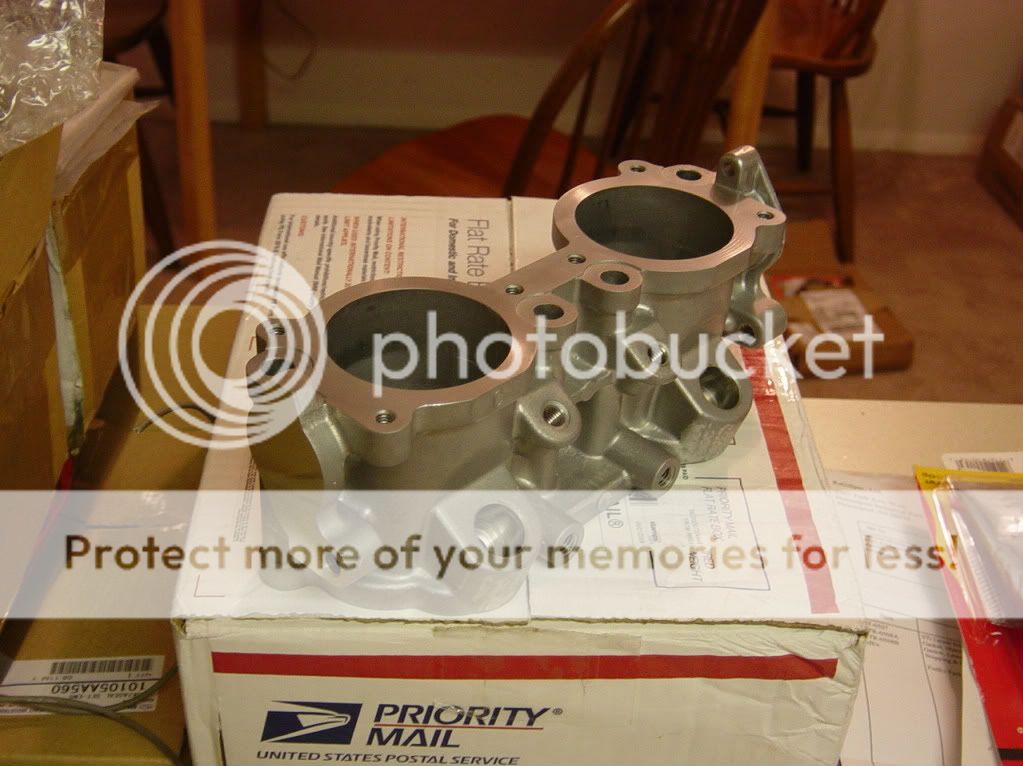

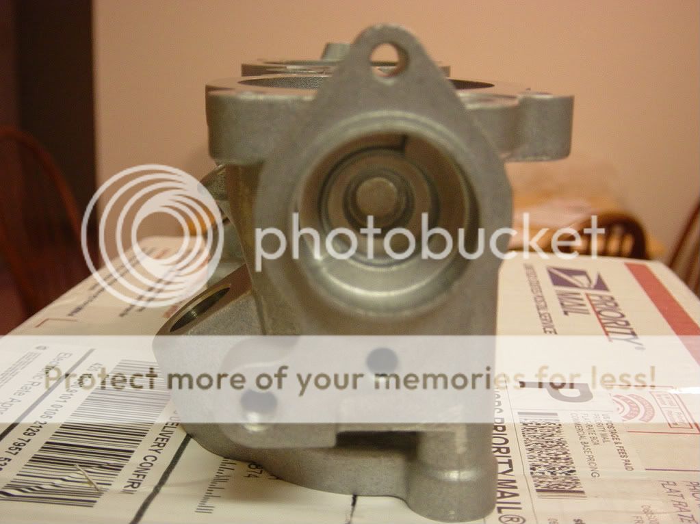

And my favorite so far - TGV-less TGV's. JDM Lower Manifolds to be exact. Since I didn't have TGV's to begin with it was cheaper to order these from http://www.RalliSpec.com
A somewhat better quality casting without the butterfly features cast/machined in

Is that the TIC timing belt kit?

Timing belt - Gates Racing

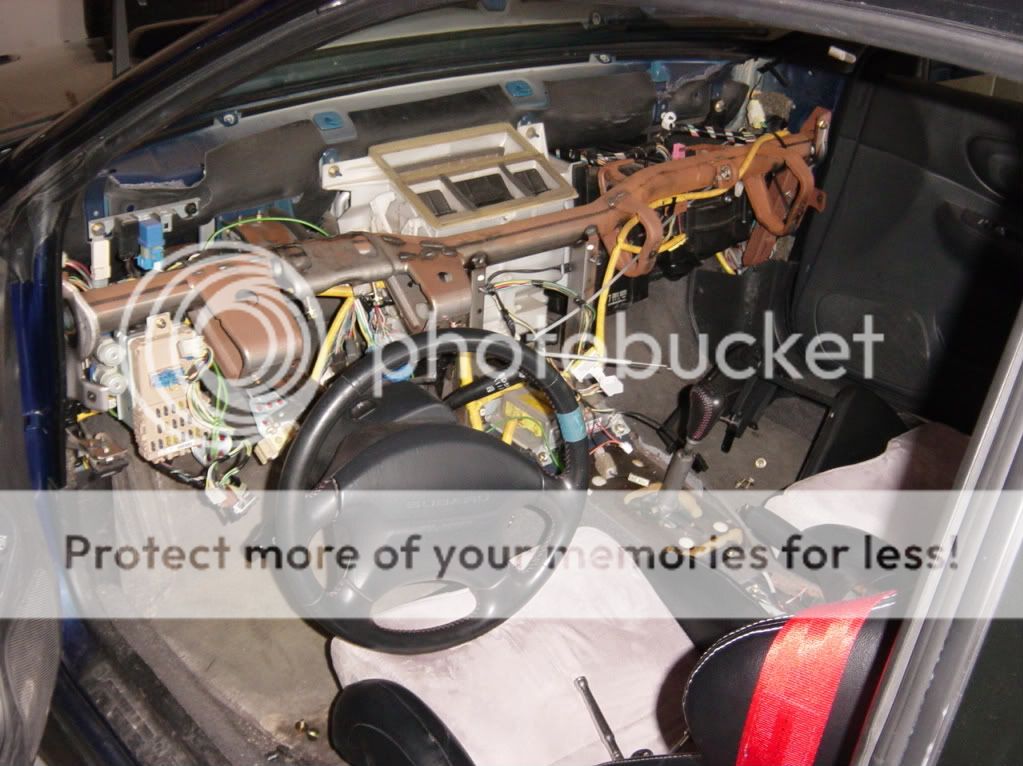

Got the dash pulled out yesterday. Fairly simple task, especially with the FSM to show you where the hidden screws are.

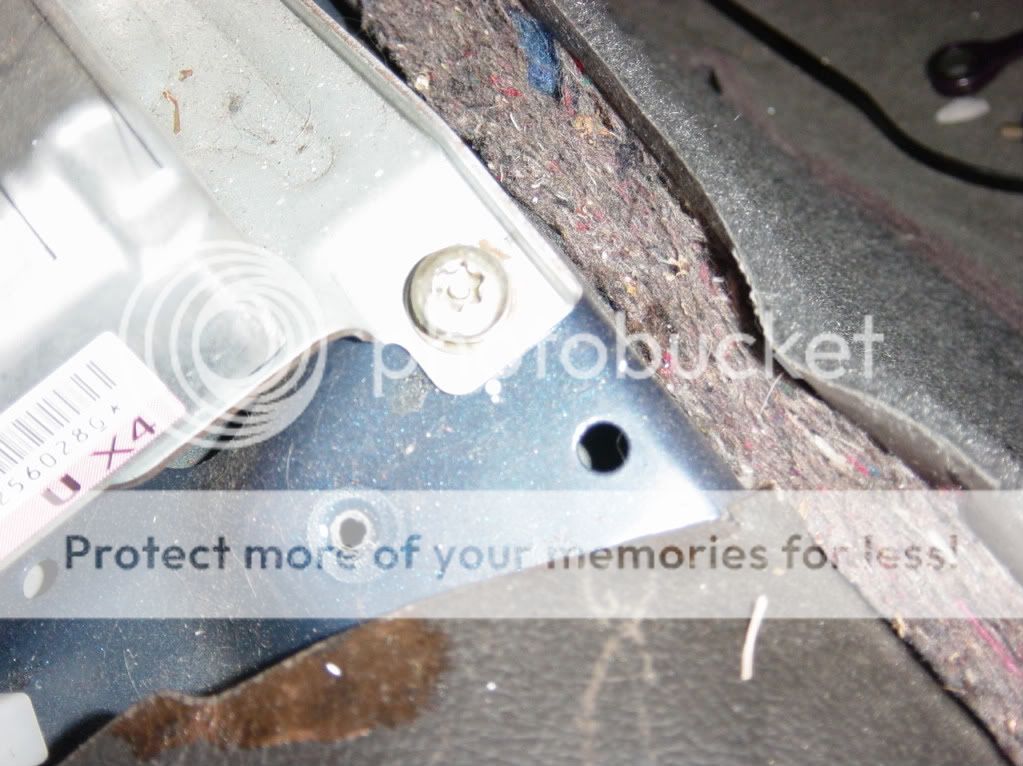

Next, I have to remove the dash bar and HVAC components. Hit a snag at this point. There are 2 bolts that connect the dash bar to the transmission tunnel - unfortunately, the also hold the airbag module in - so they're security trox IIRC.
I have a set of torx bits, but of course, they don't have the center drilled out. Any one have the proper bit that I borrow?
When I can get the dash bar out, everything else should go smoothly...I hope.

Im pretty sure rob has the security torx bits. He needed them for when we did his steering wheel!

I got a set of security bits from harbor freight a while back, too bad I don't know where they are...
