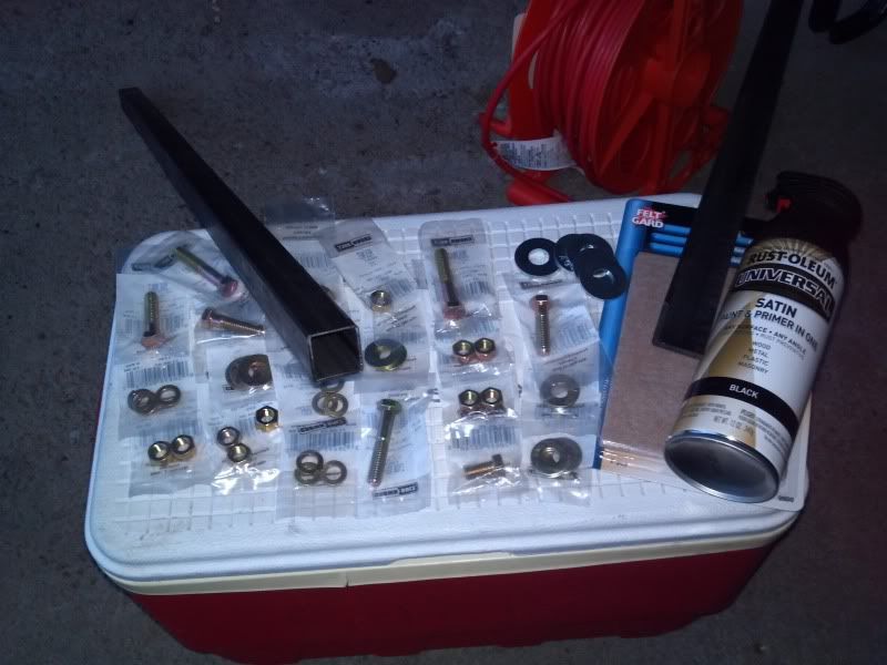

Here's a bunch of stuff I bought for my project. Mind you, the cooler and coil of extension cord are just there for a splash of color.
Updates as they roll in.

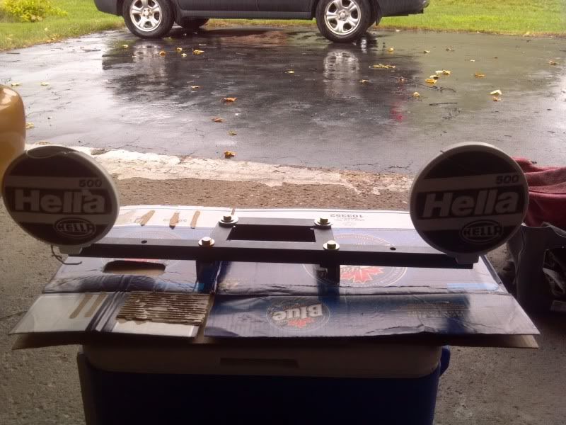

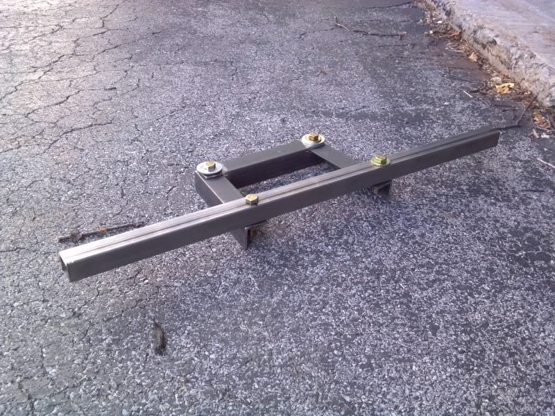

The first piece in place: I'm using the original mount points for the license plate bracket on the bumper beam. It's more substantial than it seems, and it's actually more stable and significant than the mounting of the bar on the Forester.
Here's a test fit of the main assembly. It's not that big, at 25" wide.
Next? Light bracket and wiring holes, grinding for aesthetic refinement, and paint!

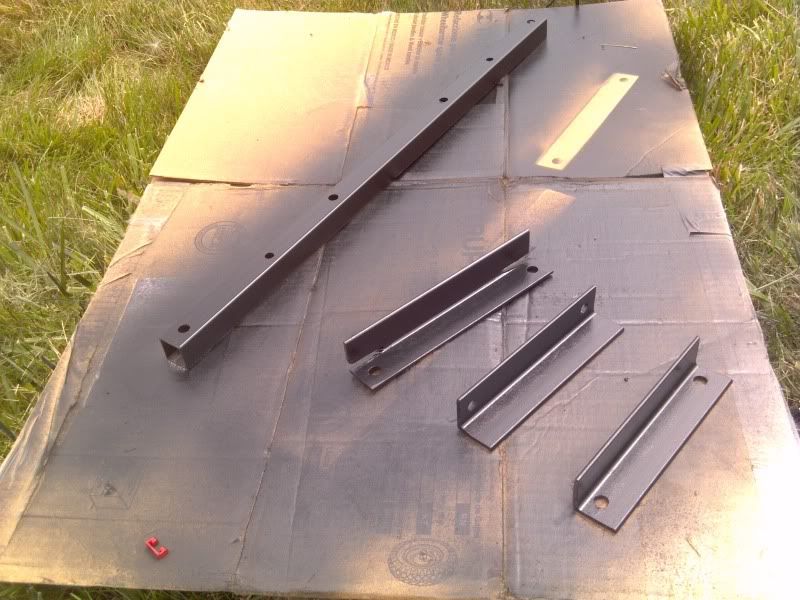

12 DAYS REMAINING:
After some final drilling and grinding, out for paint:
...and assembled:
Next up? Wiring!

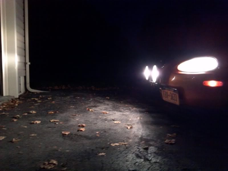

1 DAY REMAINING:
Why put it off until tomorrow?
I got this headlight jumper harness so I wouldn't have to cut the factory one:
Because the headlights are switched on the ground side of things, I ran the relay in parallel with the bulb:
After lots of harness, loom, placement of the relay, and a fuse jumper from the ABS fuse (hey, who's got ABS anyway?)... read 'em and weep:
That's two stumped non-believers! Two to go...

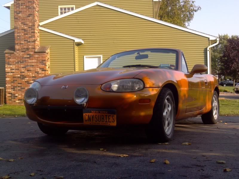

Monday, lunchtime:
Pay up, Gerrit!! :ha:
